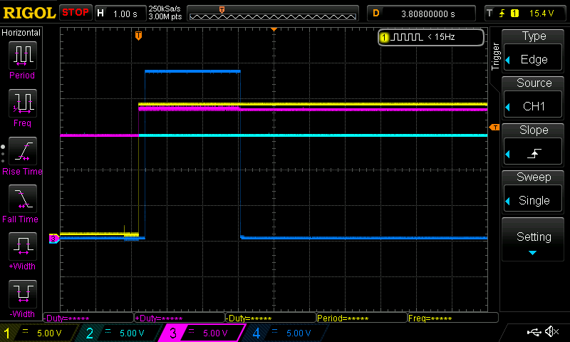

  • Below is a screen capture that shows:
    Yellow - DC IN, which is 18V
    Teal - BAT+, which is ~14.3V.
    Purple- VCC at the BQ
    Blue - ACDRV, which does to 24V for 2.5s before dropping.
    ACOK is high when the DC IN is high.
    The schematic follows Figure 18 in the datasheet.

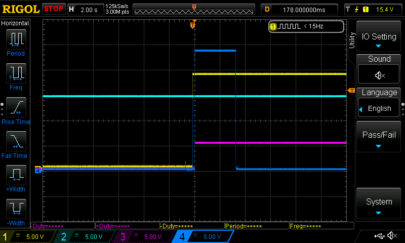

  • I've added a graph with ACOK. ACOK remains high. I also have part of the schematic.
    Yellow - DC IN, which is 18V, trigger set to DC_IN going high
    Purple- ACOK
    Shown below is a schematic of the BQ part of the schematic.

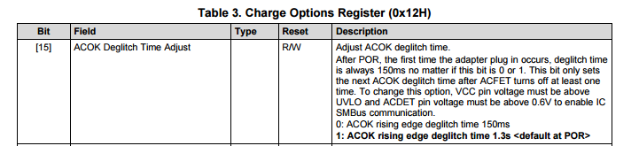

  • ACDRV has a current limit. If external Cgs is too large, the ACDRV-CMSRC voltage may still go low after the 20ms turn on time window is expired.
    In your scope capture, the 1~3 secs may be the deglitch time for next ACDRV turn-on.
    Can you please change the register setting below to see if this changes the behavior? If so, I suggest to reduce the Cgs capacitance.
  • Thanks for the pointer to this condition. However, I've looked at several boards with the problem, and setting ACOK does not seem to effectively modify the behavior.

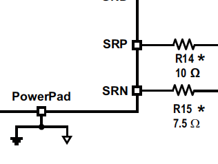

  • The largest apparent difference between the customer implementation and the the EVM are the SRN/SRP resistors R24 and R4, customer application has none, and a higher Cgs ACDRV fet (Q1 and Q2 in EVM).

  • Do you mean the customer does not have the sense resistor? The schematic customer has shown before has R68 and R73 as the sense resistor.
    Without the sense resistor, the IC cannot get input current and charge current feedback for correct operation.
  • Customer does have sense resistor, which is R68/R73 in customer schematic. Customer does not have optional resistors for better current sensing (Fig 18 R14/15 in data sheet), shown here:
  • This should not cause what we are seen here. Regarding on the register setting, does the customer has a gauge? Can you do a read of all register value after the issue occur? Some times the gauge can overwrite the values in the charger register.

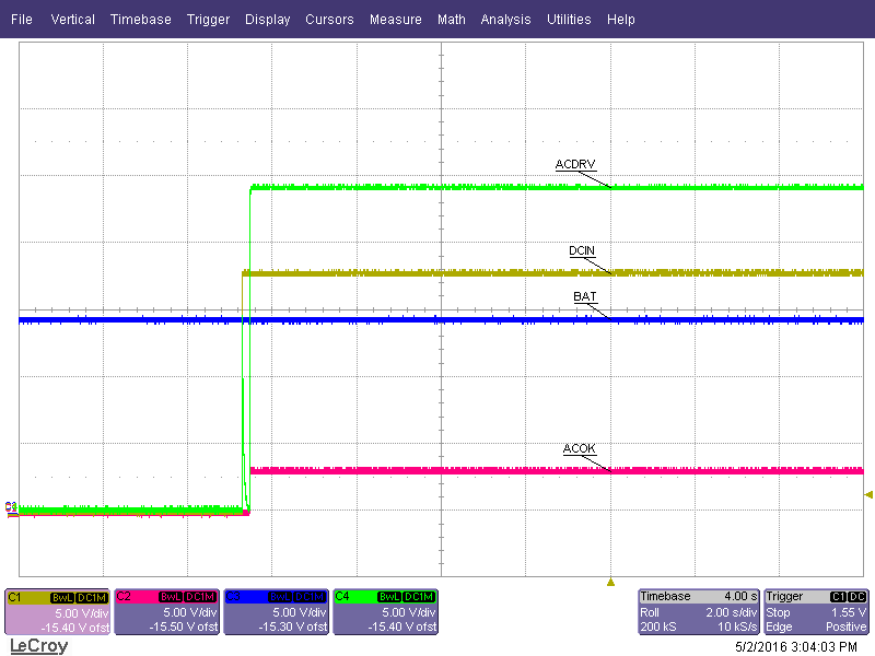

  • I have one of the boards and have been experimenting with it. It is 100% consistent in its behavior:
    - No battery installed
    - AC adapter is applied, and ACDRV jumps up to about 2 V.
    - About 160 ms later, ACOK goes high and ACDRV jumps to 6.2 V above CMSRC
    - About 820 ms after that, ACOK is still high, but ACDRV goes low, at which point ACP and ACN fall to near zero.
    - ACOK stays high for as long as there is enough voltage to feed its pull-up resistor.
    - The voltage on ACDET the whole time is about 2.65 V.
    - I see some I2C traffic about 40 ms prior to ACDRV going low. However, there are other I2C devices on the bus, and unfortunately I don't have a logic analyzer handy right now to see exactly what the I2C traffic is saying, and to which device(s) it's directed. I can say that I have another board which consistently keeps ACDRV high without a battery, and it also has I2C traffic. I can't say yet if that traffic is the same between the two boards. Is there an I2C command which can cause ACDRV to go low?
    I know I'm returning to the beginning of the discussion, but I feel like this has to be pretty simple. There are only a few things which can cause the chip to turn off ACDRV. I'm not 100% clear on what those conditions are. Section 8.4.1 and 8.4.3 talk about it, but I'm having trouble being sure that I know all of the conditions are because information is scattered, and conditions which cause ACDRV to turn on may not be fully the inverse of what cause it to turn off once it's already on. Clearly, though, it's not due to ACOK going low! So, here's my (hopefully) simple request: please list for us all possible causes of ACDRV dropping once it's high, with no battery installed, including any undocumented causes, such as a test mode, which we may somehow be tripping over.
