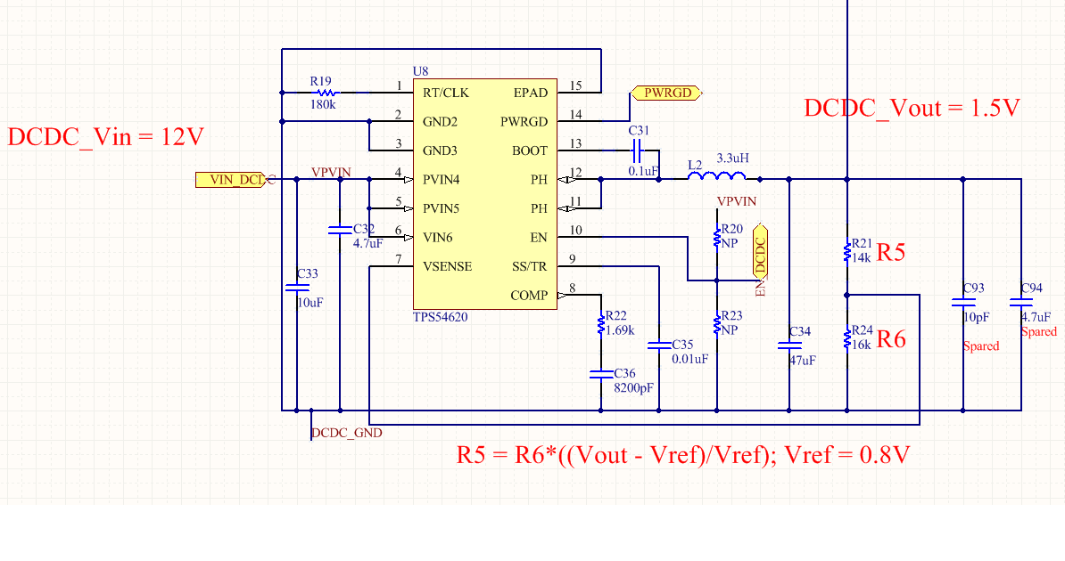

Hi Guys,
I am using a TPS54620 bulk converter on my design.  I have attached the schematic below.  The question is, when I hook up 12V at the input, there's a ~9mA drawing from my supply while output is not loaded.  The output voltage is correct, 1.5V.
