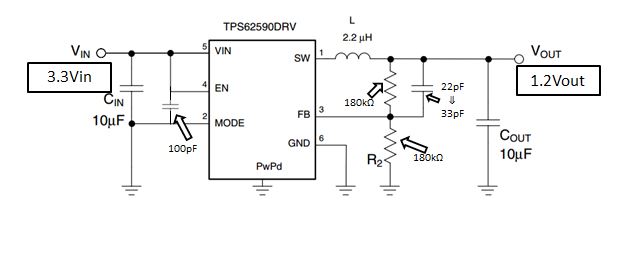

About bodeplot of TPS62590.
My customer has four questions.
Q1.
When the phase margin below 45deg, Do you have concerns such as oscillation?
Q2.
Do you have a method for improving the phase margin?
Q3.
I have changed the feedback capacitor from 22pF to 33pF, And then the phase margin grew bigger.
Why, the phase margin improved?
Q4.
Should I increase the feed-forward capacitor?
