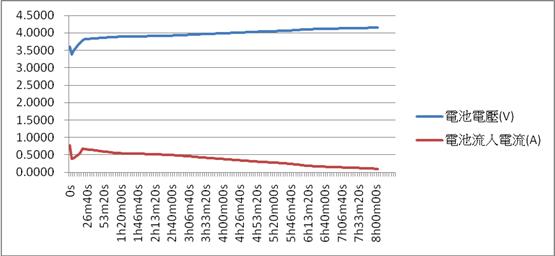

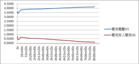

BQ24092 lithium battery charging question
Hola,
I have a question about BQ24092 charging issue below:
Why used the CC mode with 3.5V charging voltage but it's not charging with the constant current? Thanks ~
BQ24092 lithium battery charging curve:
Schematic:
Below is the battery spec:
