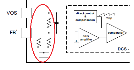

Please let me know about internal resistance value and accuracy of TPS62172.

⇒I think that cause is depend on internal feedback resistance.

    4% difference is likely normal in PFM mode. In any case, the few uA of current drawn by the FB divider is not the cause of the efficiency difference.
