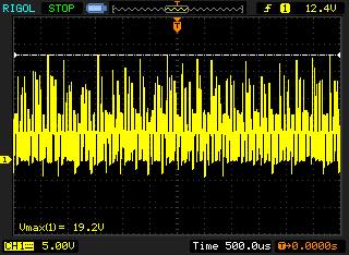

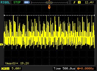

  • Thanks for the help with the layout. When you say you need waveforms are you saying you need them of the actual second of failure? Right now with a supply voltage of 13.5V the voltage on the pins are as follows
    pin 1 - 800mV                                     pin 8 - 1.2V
    pin 2 - 13.5V                                       pin 7 - 200mV
    pin 3 - 1.2V                                         pin 6 - 800mV
    pin 4 - 200mV                                    pin 5 - 400mV
    waiting a few minutes I get a sudden burst where it looks like its trying to power back on and I get the following waveform on pin 8. Second later its back to the failure with 1.2V on pin 8.
    Do you think the inductor needs to be changed?
  • Generally speaking, dc voltage measurement of the pins are not very helpful for troubleshooting.  I can't really tell what is going on in the waveform as the timescale is to long.  It needs to be 10 usec/div or so.  Ideally you should trigger on the voltage dropping out so I can see what is happening immediately before and after the drop out.
