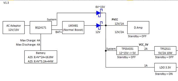

Hi Support,
If customer use LM3481 as a boost regulator (instead of SEPIC, more complex). Is the circuit still work stable if Vin = Vout?
This condition happen when user plug in a 12V adapter, but the original source is from 2 Li battery in series, around 8.4V.
Thanks.
