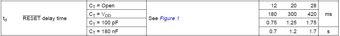

I found a lot of posts about this and I have a feeling there is no precise answer here, but my customer is using the TPS3808 and is trying to get the worst case min/max delay time for a given Ct. There is an equation in the datasheet to approximate this, but we are wondering how to bound the min/max.
Looking at the spec table, it says for a Ct of 180nF, the delay could range from .7s to 1.7s. Then if you load the equation with 180nF you get 1.03s.
It's nice we have a bound for a couple of extreme capacitor choices, but is there a way to bound the min/max for a cap value of our choosing?
