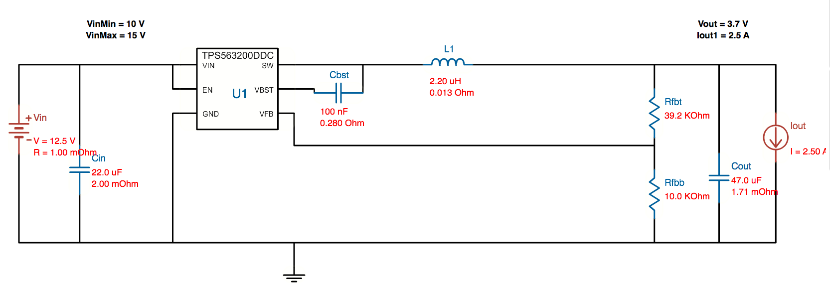

hi guys, currently im designing a power supply for my gsm module with these restrictions:
- Input voltage: 10v min and 15v max
- Output voltage: 3.7v
- Output current:-Peak (worst case): 2.5A
                        -Continuous (worst case): 650-700 mA
the question is that TPS563200 fit with my requirements or not? if not what's the good solution in my case ?
