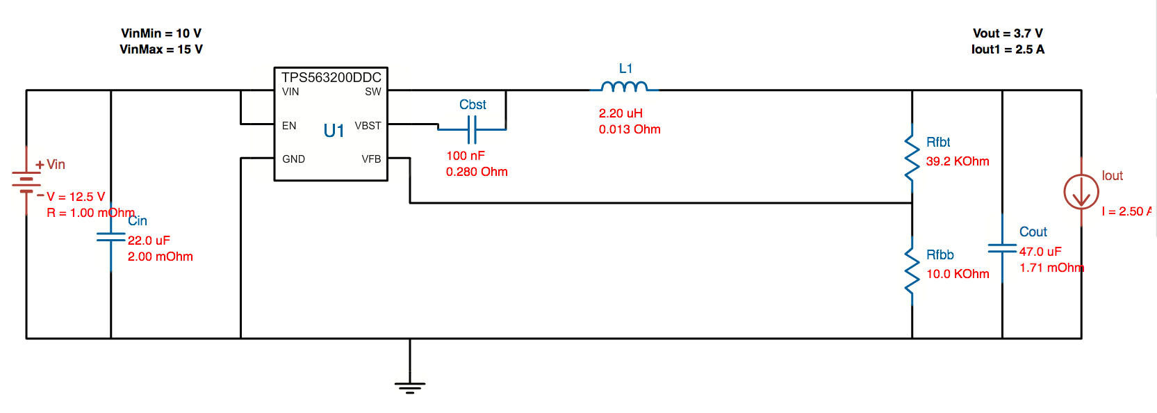

That is a pretty generic input and output. There are literally dozens of possible options, depending on your specific care abouts. TPS563200 is one possibility.
