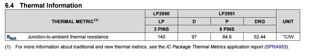

We would like to use LP2951-50DRGR (SON PKG) in our product. Our power requirement is as follows
1. Input voltage-24V, Output Voltage-5V, Output current- 30 to 50mA.
2. Our board is 6 layer board with 1 dedicated GND, 1 dedicated power layer. Size of our board is 1.75 inch x 2.75 inch. Maximum area of copper pour including GND, PWR, DAP available is 15 mm2  in top and same can be provided at the bottom as well. Voltage regulator will be placed in top of the board.
3. Maximum operating ambient temperature for our product is 40°C.
4. From the datasheet, i found thermal resistance RθJA as 52.4 °C/W.I am unable to find RθJC (thermal resistance till case bottom) Considering that in our board we really don't have lot of space in top/bottom to have copper pour  ( Only 15 mm2 in top is availabe) what RθJA should be used for calculation? I tried to do thermal simulation in workbench for the same but I am unable to find simulation model for LP2951CSD/NOPB (SON package, SOIC package is available) in TI website. Could you please provide recommended thermal resistance for power dissipation calculation in our board?
