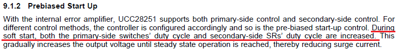

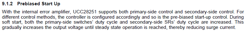

Hi Team,
The datasheet shows the following about "Prebiased Start Up".
Is there timing chart of OUTA/OUTB and SRA/SRB in prebias start up?
Yaita / Japan disty
  • Hi Yaita-san,
    The timing diagram would show an increasing duty cycle for the OUTA/OUTB and SRA/SRB outputs. You can think of the timing diagram similar to Figure 26 where if more then the one switching cycle is drawn, the duty cycle would increase until the design reaches steady-state. The starting duty cycle is described in sections 9.1.2.1 and 9.1.2.2. Does this help you?
