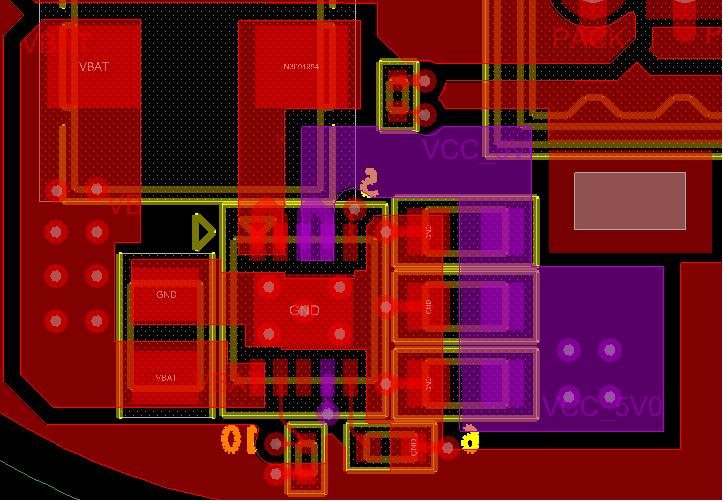

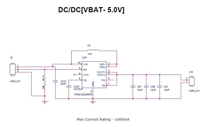

I use TPS61232 in one of our designs. The input for the IC is given from a Li-ion battery(3.3V-4.2V). At no load condition the IC is giving out the expected voltage of 5V.
Once I connect the load the IC fails after working like 6 or 7 times. After the failure the input voltage is reflecting at the output. This is same in all cases. We burnt like more than 4 ICs.
The design is taken from webench.
