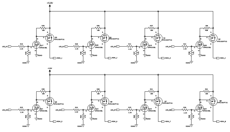

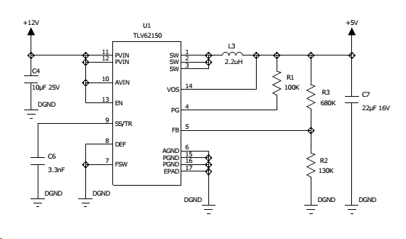

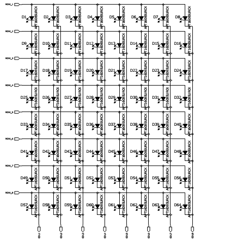

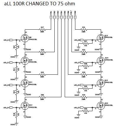

I have used TLV62150, for 5 Volt OUT Option.  My input is 12Volt & Output is 5 VOlt. When i connect a load it consume lot of current in losses and i am getting lower efficiency of the Converter.
Can you please check attached schematic and let me know how i can improve the same.
