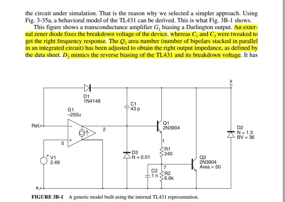

What's the function of the Diode D3 in the internal circuitry of TL431 ?
Other Parts Discussed in Thread: TL431, ATL431
The  internal circuitry of TL431 is as follows.
The picture is from the book "Switch-Mode Power Supplies, SPICE Simulations and Practical Designs, Christophe P. Basso", Page 327
Thanks very much

  • Jankel,
    I've contacted the product group here. I believe the highlighted refers to D2. Are you asking about D2 or D3?
    In general, you may also want to look into the much improved version of this device the ATL431.

  • Hi, John,
    Very nice to receive your reply.
    oh, i'am sorry, the highlighted is only my note, it does nothing with this topic. Effective information for this topic is only the schematic in the picture.
    I guess that D3 plays a protective effect of proventing the 'BE' junction of Q1 from reverse breakdown,
    and i guess D3 may be a schottky diode ?
    Best Regards.
    Jankel
  • Since this is a generic behavioral model that does not represent the actual TL431 internals, and D3 appears to be 'ideal' diode other than 'N=0.01' (Emission coefficient), I would guess that D3 is strictly to promote convergence by providing a current path to clamp G1 output at start-up when the Ref input is less than V1 (2.49V).
    This question would probably be better directed to the author and/or publisher of figure 3B-1.
