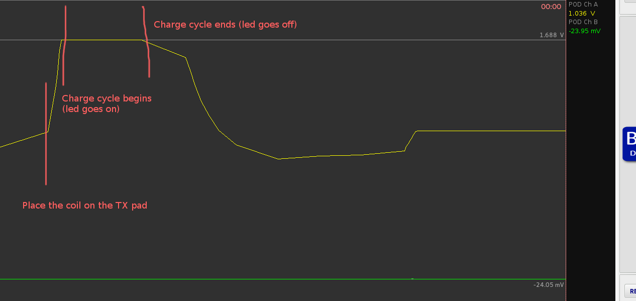

  • Ok so I measured the BAT pin for voltage. Also replace C2 with the suggested 2.1nF using two caps in parallel.
    Nothing really happens voltagewise during the chargecycle other than that the !charge pin goes low. So it's not really charging. led is probably driven entirely from the battery..
    Tried without a battery as well. Charge led actually is lit for about 10 sec in both cases, not the stated 5. But I guess that is not too important?
  • Miore tests. Now taping the coil down to the charge pad and positioning it tight centerwise. Actually manage to get charge led kept lit for "ever". Problem still is that voltage across battery keeps dropping as the led discharges the battery. Now current/voltage supplied on the bat pin as expected. is this a RECT issue? The Ros was selected kind of randomly based on the other threads on this community to 43.2k. Rest of resistors per appnote. Will buy some more lipo 3.7 batteries in case the ones Im testing with have issues. Will report back with fresh ones.
    Board increases in temperature somewhat ~35-40degrees. Heat most noticeable underneath the bq51051b. 4 vias to large ground poor. should not be an issue?

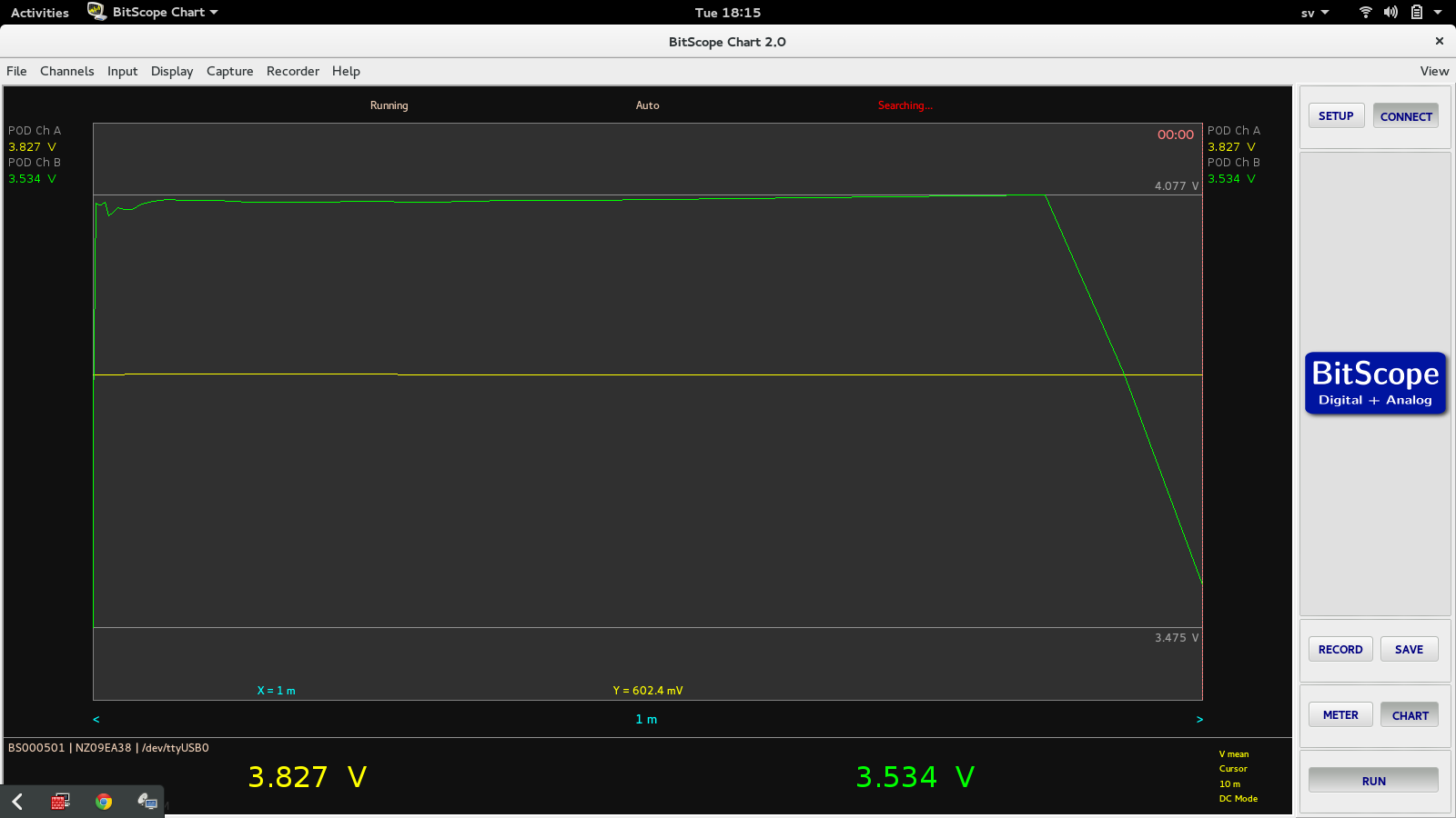

  • Placed a probe on rect for about 30 sec.
    The slope is from when I removed the probe.
    Rect = Green (~4.02V)
    Bat = Yellow (3.827V)
  • Fredrik,
    Good news on the 2A charger.  RECT is simply the rectified voltage coming from the AC1/AC2 lines.  RECT is the voltage that is controlled internally (through communication with the TX).  There is really nothing special that you need to do - except for the capacitors.
    The RECT plot you have shows RECT just above BAT (about 275mV) which is where it should be.
    Based on this, the BAT voltage should rise over time as the battery is charged - not be depleted like it seems yours is.  That indicates to me that the charge current is not making it to the battery somehow.  How long did you run the system?

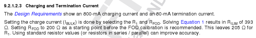

    Continue reading the pdf and get a bit confused on this calculation.
    It states that RILIM = R1 + RFOD on page 20.
    To me it looks like the text recommend setting RFOD = 200 and R1=205  which results in RILIM=393
    Not really inline with the formula on page 20 section 8.3.4.3.1??
    Still no current flowing to the battery.
  • Fredrik,
    You are correct that the numbers in 9.2.1.2.3 are incorrect.  RILIM = R1 + RFOD is the correct equation.  So, if RILIM = 393 (from RILIM = KILIM/ILIM: 314/800mA) and RFOD = 200, then R1 = 393-200=193 (not the 205 shown in the datasheet discussion).
    Choosing 205 for R1 would yield:  ILIM = 314/(200+205) = 775mA.
    If the CHG pin is still active (LED on) then the bq51050B recognizes that a battery is present and is trying to charge.  Would you be able to use a source meter in place of a battery?  I set the voltage level to 3.5V and set the current limit to about 10% greater than the expected charge current.  This will allow us to see exactly how much current is going into the system.  Without a voltage on the BAT pin, the output won't turn on.
