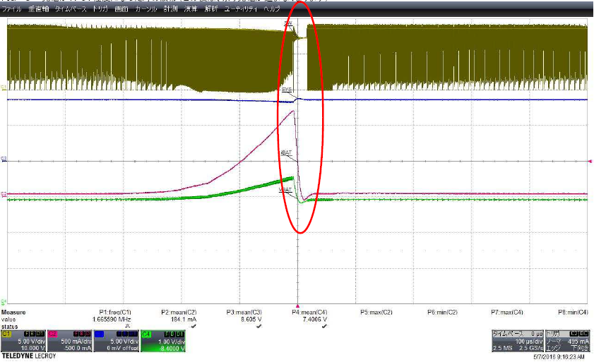

We observed that the charge does NOT become termination for BQ24170.
We could  duplicate at BQ24170-002. Following a capture.
In this cases the BQ24170 becomes non-continuous mode and then does not get termination condition.

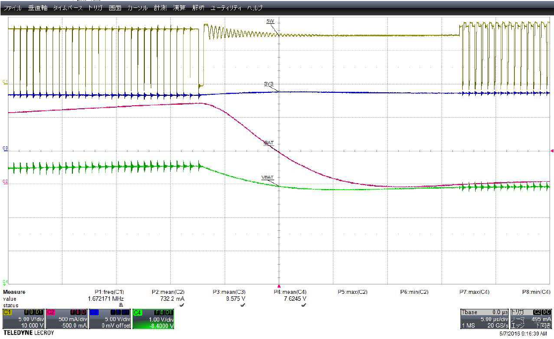

Since it is about to Max duty, I suspect skip mode, but I think it is too long (around 22us)
Could you let me know the detail of this phenomena, and how to resolve if possible?
Yellow : SW / Blue : PVCC / Pink : Charge current / Green : SRN
1) Non-continuous mode
2) Zooming
