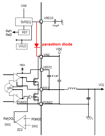

Hi Team,
We applied the voltage to VIN1 only.
However, around 5.0V appeared in VIN2 at the same time.
Is this phenomenon correct operation?
If yes, could you please let us know the reason?
(For example, Is there a parasitism diode between "VREG5 output" and "VIN2"?)
