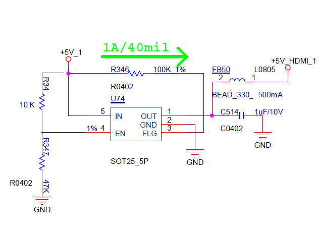

Hi Sir,
I did the design with the TPS2051B as the following sch.
TPS2051 will connect the DP cable to the TV or the displace devices. This cable could be the active cable or the passive cable.
so if the circuit is operating, and the DP cable is always connected, everything is good.
But when we remove the DC5V power, we found the reverse current is from TV by the active cable to TPS2051.
and TPS2051 did not block it.
Did I get someting wrong, or how could we fix it ?
BR,
Mac.
