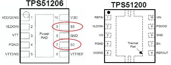

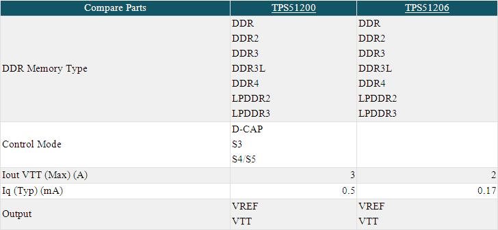

I made a comparison table of TPS51200 & TPS51206 below:

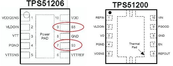

But I found a problem of pin define in data sheet below:

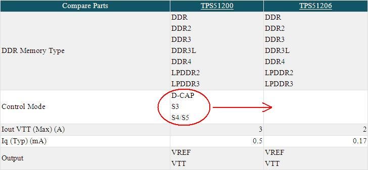

You can see that the TPS51206 has S5/S3 pin and the TPS51200 with S5/S3, but the comparison table as above shown TPS51200 has S3/S5!
Is it has some typo for the comparison table and they are should be switched each other like below?right?
