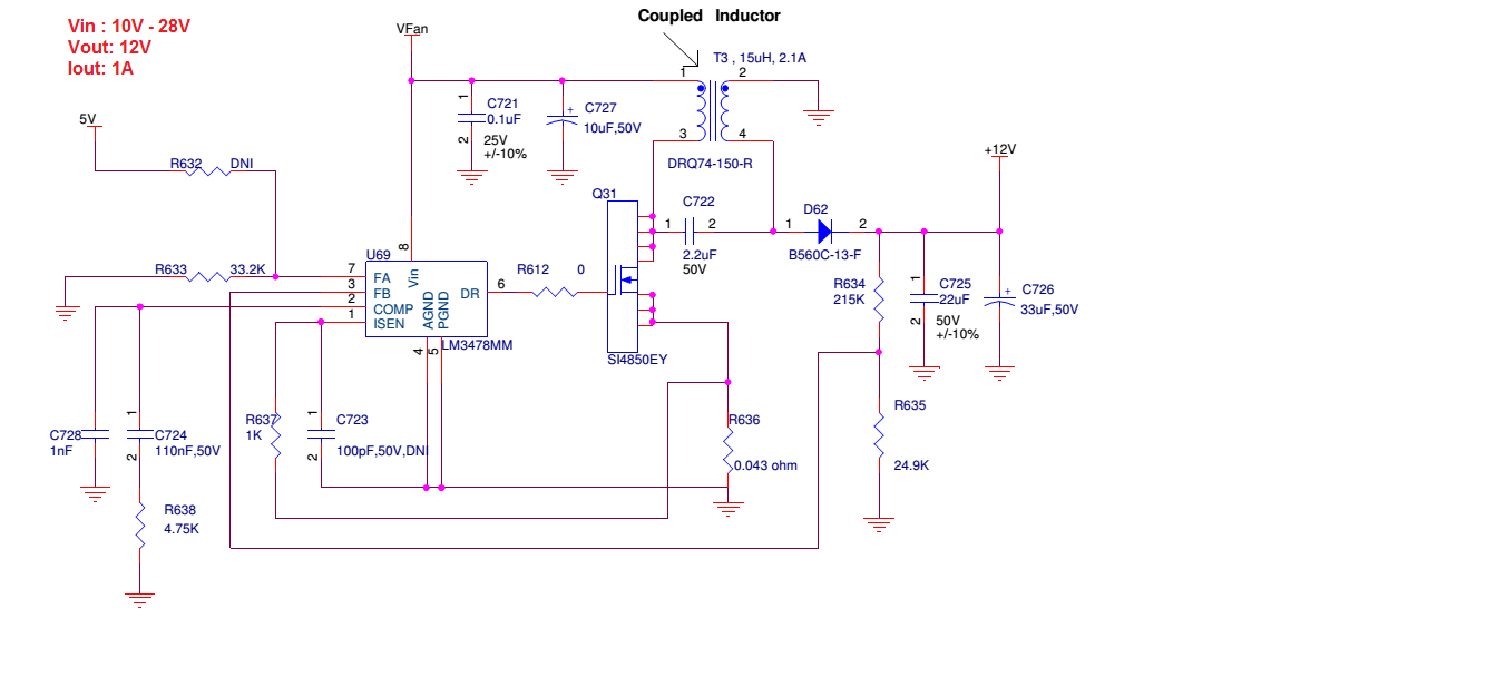

I want to use LM3478 as sepic converter for following design parameters:
Vinput: 10V - 28V
Vout: 12V
Iout: 1A
I have attached the schematic for  reference.  I have used Appnote AN1484 for equations.
Please let me know anything need to be done for optimization. Anyone who has used LM3478 based sepic converter can share their experience too.

  • Hi Mitali,
    Without detailed check of your calculations, schematic looks OK.
    One suggestion would be to slightly increase output capacitance value (C725) to 47uF.
    Brani

    I have calculated following basic parameters as per AN - 1484:
    1. Duty Cycle : 56%
    2. L1=L2=L = 25uH, I have taken coupled inductor so L=15uH is choosen
    3.Peak Currents of Inductors: 1.5A and 1.2A
    4. Peak Mosfet current: 2.7A
    5. Vsense = 130mV (from datasheet graph)
    I will surely go for higher output capacitor value.
