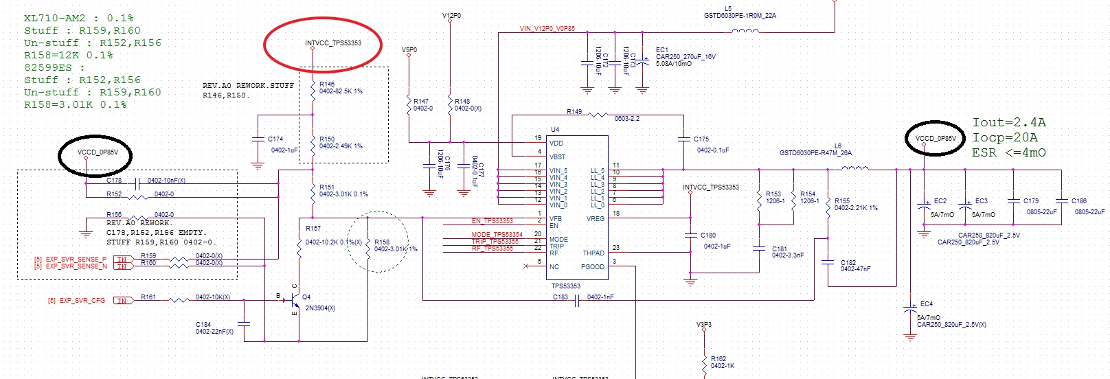

Dear Sir
below is intel reference design for TPS53353
Please refer to below red mark ,TPS53353 FB pin connect pull up resistor to VREG pin ,is it correct
is the schematic workable ??
I would not connect any part of the FB circuit to the VREG5 output. It is not very accurate and could cause your output to be unpredictable. Also the schematic says the output is 0.85 V. I calculate 1.2 V or 1.377 V, depending on the state of Q4.
