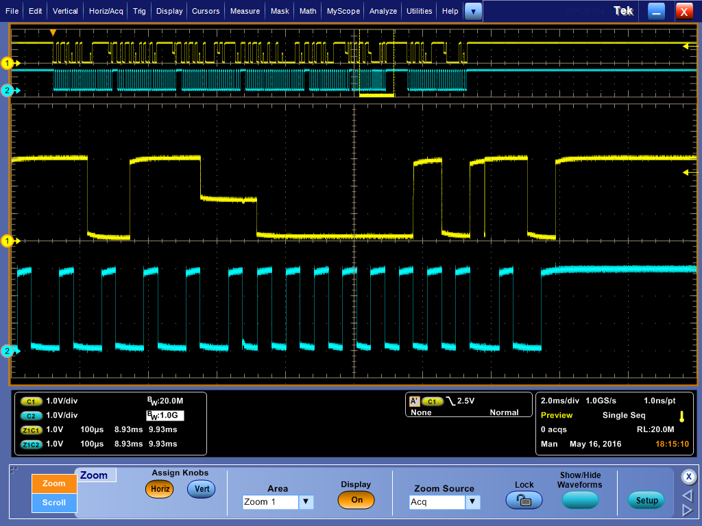

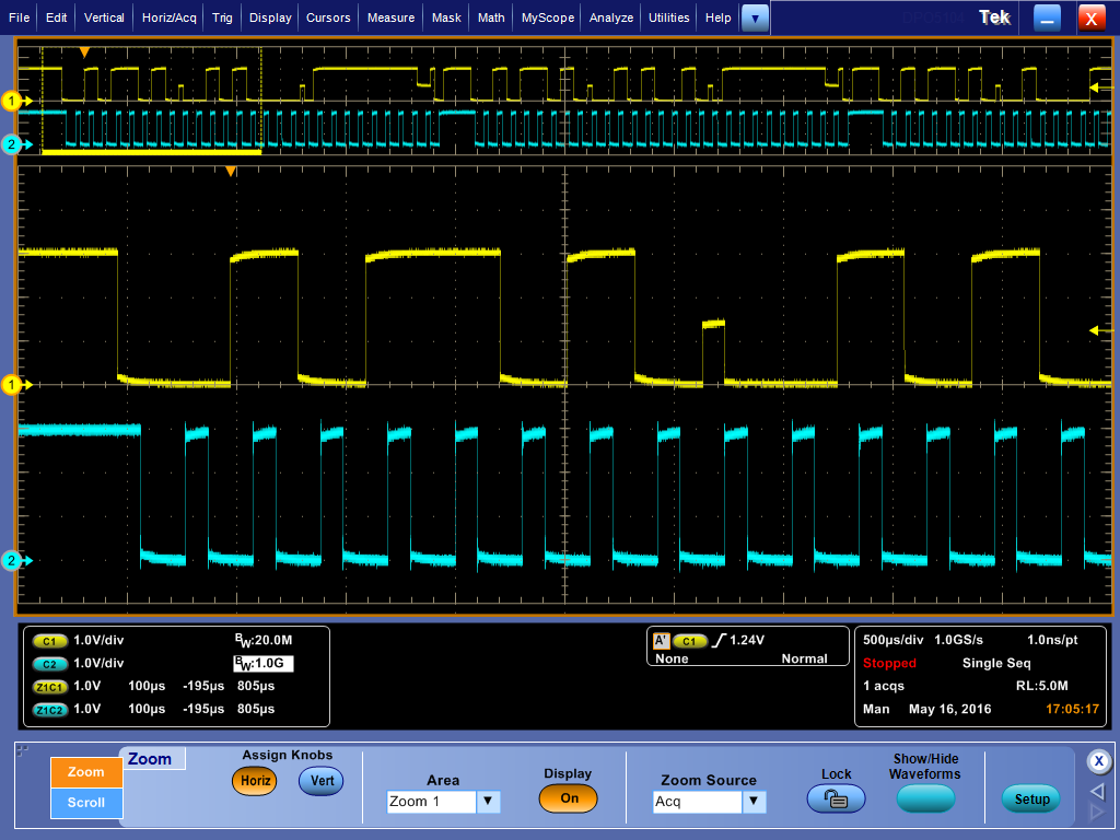

    In fault device have below 3 point problem .
    1. SWIO =0V (normal 1.8V ) SW1 = 0V (normal 1.2V ) ,SW2 and all LDO is normal.
    2. PWRHOLD pin add strong pull down the TPS689101 not shutdown.
    3. I2C can not communication with " TPS65910 EVM Software".
    4. Disconnect the device power after reopen device above problem back to normal.
    In the device can not remove the battery.

  • Hi Richard .
    Below is TPS65910 at the system sleep and wake up operation code .
    sleep
           TPS659101_IIC_SendByte(0x50, 0xff);
    TPS659101_IIC_SendByte(0x52, 0xff);
    //TPS659101_IIC_SendByte(0x31, 0x06);
    //TPS659101_IIC_SendByte(0x43, 0xba);//10111110
    TPS659101_IIC_SendByte(0x43, 0xbe);//10111110
    TPS659101_IIC_SendByte(0x44, 0x06);//00001110
    tmp = TPS659101_IIC_ReceiveByte(0x3F);
    TPS659101_IIC_SendByte(0x3F, (tmp|0x02));
    wake up
     TPS659101_IIC_SendByte(0x51,0xFF);
    TPS659101_IIC_SendByte(0x53,0xFF);
    TPS659101_IIC_SendByte(0x50,0xFF);
    TPS659101_IIC_SendByte(0x52,0xFF);
    System wake up TPS659101 I2C signal.
  • Hi ZuXing,
    If the issue occurs after using the wake up routine, it is probably due to the masking of the interrupts, specifically in register 0x50.
    Masking PWRHOLD and PWR_LP_IT should cause the behavior you are observing.
    Also, some of your comments varied from the values you were writing, such as turning off VDD3 in sleep mode.
