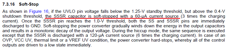

The datasheet shows the following about soft-stop.

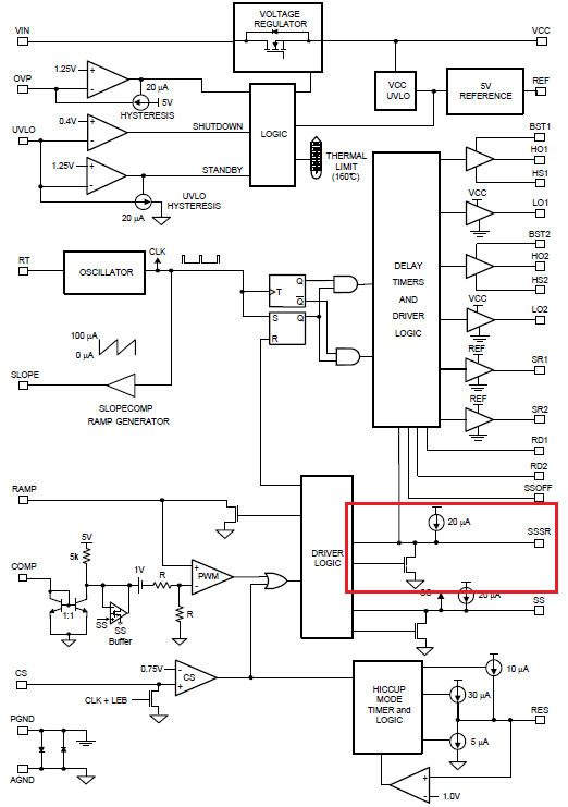

However, I couldn't find "60uA current source" at SSSR pin in functional block diagram.
In addition, I believe it isn't "current source" but "current sink" is correct.
