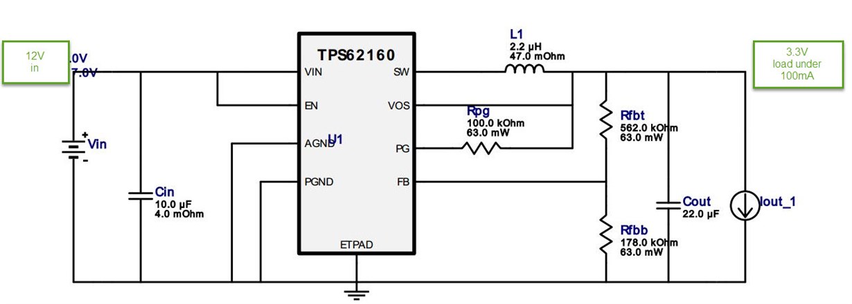

I am trying to sue TPS62160 with 12V battery input and 3.3 V output with the load current under 100 mA - most of the time around 50 mA
When I look at the output without load its very stable but when connecting the load it starts moving dipping 200 - 300 mV from time to time with some repeated slow frequency  and i can see some small pulses somewhat repeated the input of the inductor?! The same works fine if input voltage is under 5 V
I've tried different value for the resistors as well ( 6.34 K / 2 K) and it seems slightly better but output still unstable!
When its without load I see short pulse with about 1Khz on the inductor input, and when load is connected the pulses goes with much higher frequency 100Khz +  so seems the regualtor is workign but does not hold the voltage
Any idea what is happening and what can be done to make it stable and hold the voltage under the load!?

  • Can you post waveforms of Vin, Vout, SW, and inductor current that show what you describe? Can you post your PCB layout?

  • No, there is no difference in operation as Vin is varied. This is why I need to see waveforms and your layout to see what is happening.

  • Yes, you can post waveforms for both Vin conditions.
    A picture is worth a thousand words. Showing me what your circuit is doing is much better than using words to explain it.
