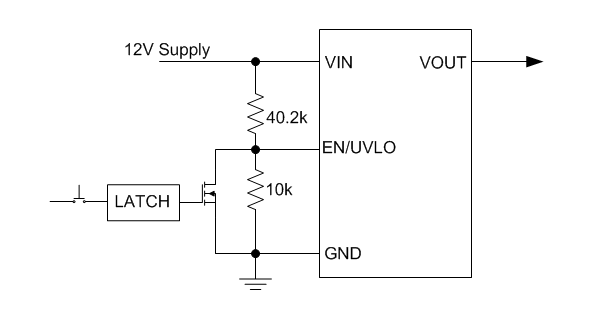

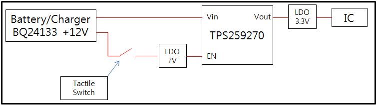

Hello All,
I'm trying to make a portable speaker and I want to reduce current leakage during the operation as much as possible.
I decided to place a TPS259270 Load switch in between the Power source and my ICs.
It's my first time using a load switch, so I'm not sure if I'm understanding right.
Because of the speaker design, I need to use a tactile button to enable/disable the load switch.
Converting the tactile switch to work like a latch is another thing that I have to figure out, but most importantly
Can the schematic like below work?
I saw that the EN/UVLO pin's max voltage input is 6V, so does that mean I can use any linear regulator(LDO) that supplies voltage under 6V?
