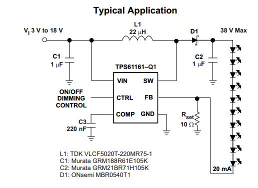

Hi ML&P AE team,
Our customer Siemens has some concern about TPS61161. Could you kindly reply to this?
1. What is the Error amplifier crossover frequency 500kHz?  The 500kHz is the crossover Freq of the EA or the feedback loop?
2. How does the crossover freq change with the value of the compensation cap?  Could you show me the Loop transfer formula of this device?
3. How to choose the value of the Cap?  In the Table, it says 5 pF connected to COMP; but in the application circuit, C3=220nF.
