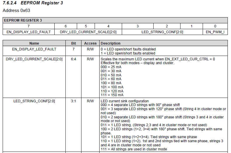

LP8860-Q1 has two Mode, i can see detailed introduction about this two mode in datasheet, but i can't find how to configure the Mode in the datasheet, could you please help ?

But looking at the datasheet, you will be able to set cluster mode by changing LED_STRING_CONF[2:0].
And then you will need to program brightness/current settings on register 0x00 ~0x0C for each cluster.
