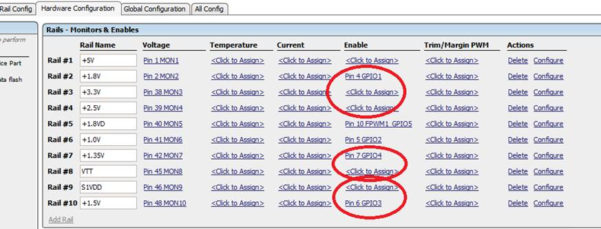

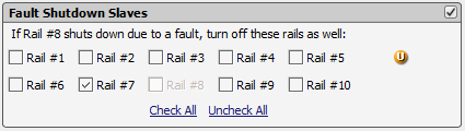

 Now our challenge is, in the tool we were not able to assign same pin (GPIO) for multiple rails. For eg. As per our above representation, we should have Pin4 GPIO1 for all there rails #2, #3,#4. But when trying to do so, once the PIN4 GPIO1 is assigned for one rail, for other rails that pin is not available to assign. Kindly refer the snap shot
Help us to resolve this assignment issue.
    [1]  For the MON11 pin,  when the input signal of ADC is below 0.2V, the conversion results may be inaccurate. So as long as this inaccuracy will not affect your application, you can use MON11 for voltage monitoring.

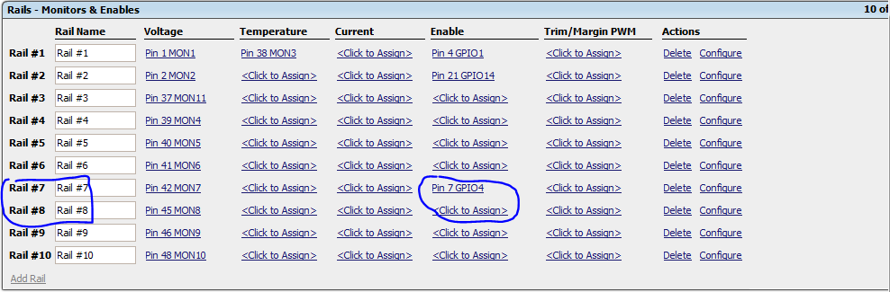

    [2] For the enable assignment, we cannot assign the same GPIO to several  power rails by GUI. But you can have this connection on your PCB board. If so, Please pay attention to your configuration.

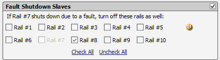

    For example, if we want Rail #7 and Rail #8 to share the same GPIO, as below:

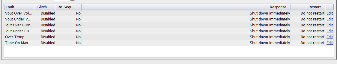

    firstly, configure Rail#7 and Rail#8 to be fault shut down slave of each other, as below:
    then, go to Fault response window of both Rail#7 and Rail#8, configure the fault response as "Shut down immediately".

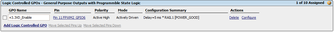

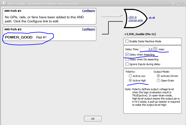

    You can assign GPIO6 as the Enable signal of rail #11, as your description, the +3.3VD rail will follow +3.3V rail after a specific delay. So you can go to the Logic controlled GPO window to configure it, shown as below:
    The GPIO6 pin will follow PGOOD signal of +3.3V rail after a specific delay.
