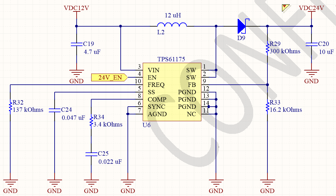

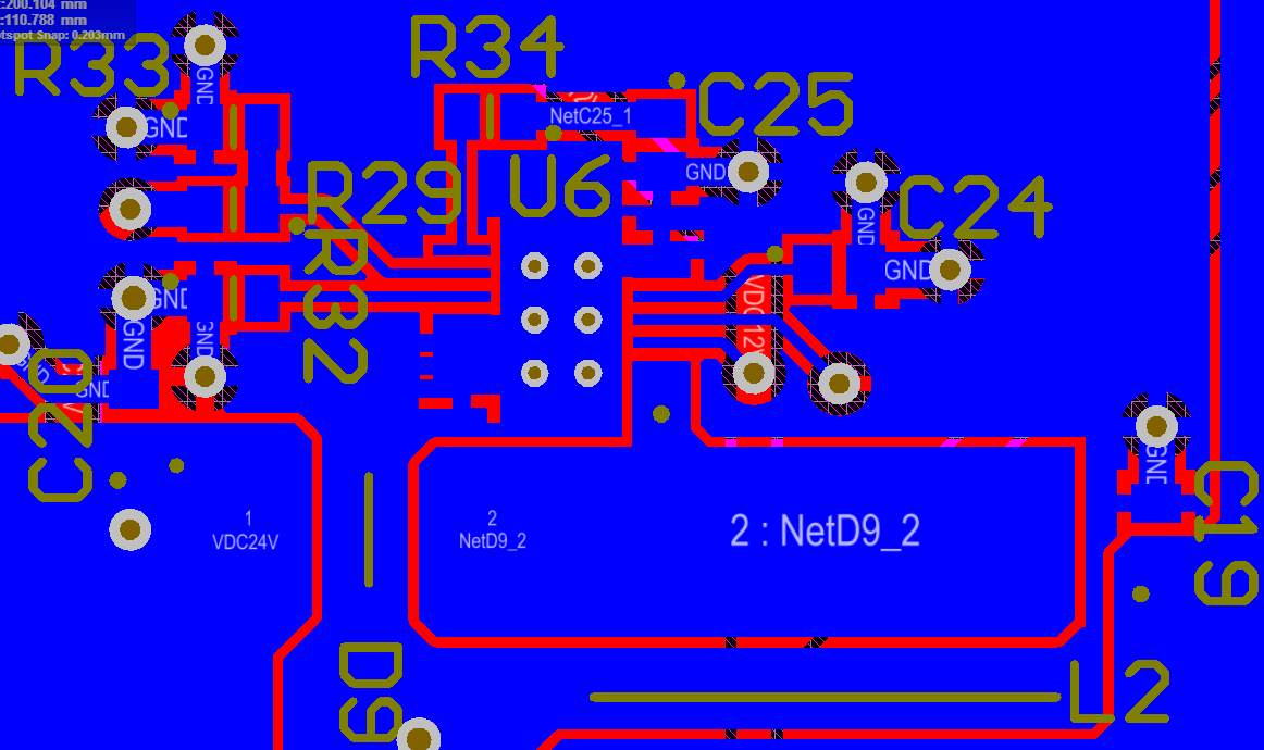

Hi everyone,
I'm using a TPS61175 for boost an input of 12V to 24V. I got an output of 11.7V and assumed that the regulator was not working. I checked the enable pin for sufficient voltage (3.3V from microcontroller). After few minutes, the regulator suddenly blow up, near the SW pins (1 and 2). Any comment what is happening? Schematic and PCB are attached below.
Best regards.
