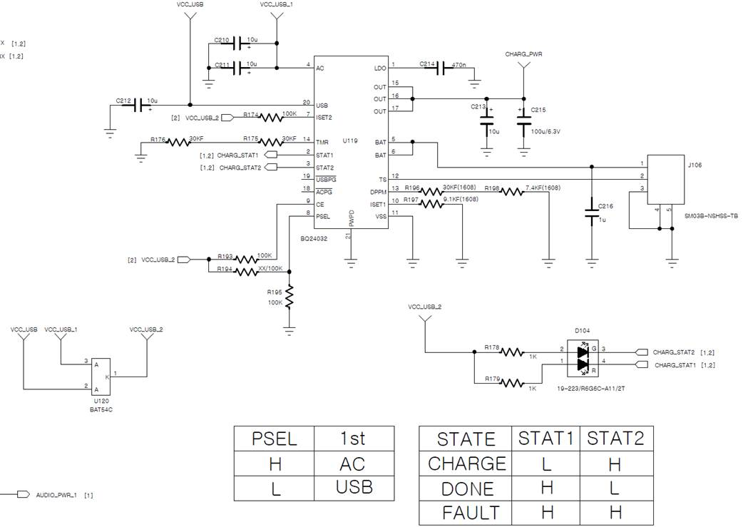

Hi Tiers.
My schematic is below.
When USB Input, charging termination is good at 11mA.
But When AC Input, charging termination is not completed. charging state under 11mA and keep charging on.
So I changed R195 (7.4K Ohm -> 5.1Kohm), and then charging termination is completed under AC input.
I want to know why.
Please let me know.
