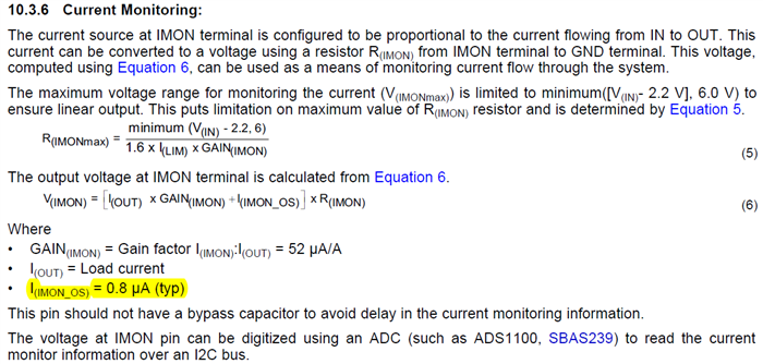

Hi Team,
I would like to know about offset current of IMON(min/typ/max) at FET mode and diode mode.
I understand typical value is 0.8uA at FET mode.
Could you please let us know if you have min and max value at FET mode?
And, if "offset current of diode mode" is different from "FET mode",
could you please let us know if you have min and typ and max value at diode mode?
*This value does not need to be a guarantee.
