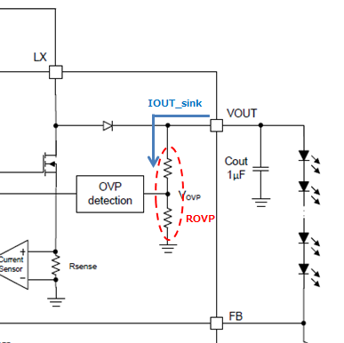

My customer is currently in using TPS61158, now.
I have gotten a question about this product .
So, please teach me about TPS61158.
<Question>
I want to know the sink current of VOUT pin (IOUT_sink) when "CTRL = Low".
What Ω is feedback resistance value of the OVP (ROVP).
Could you help us?
Masumi Sekiguchi
I will need some time to gather details on the information you requested.
The datasheet Iq max spec of 1uA includes the current into the OVP voltage divider. Therefore, the total resistor value should be in the mega-ohm range.
Thanks for the answer .
I want to know the time until VOUT Pin voltage = VIN(CTRL = L)
So, please continue to check the specific resistance value.(what MΩ ??)
Waiting for the answer, thank you.
