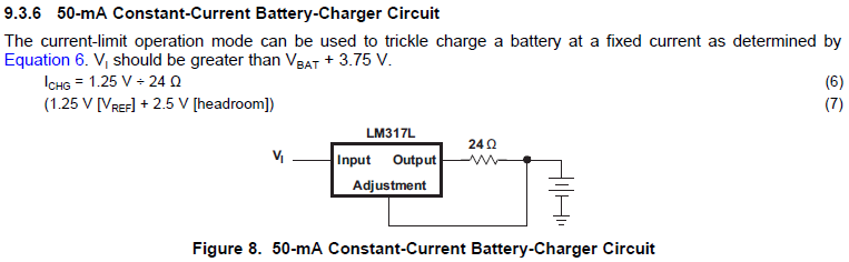

My customer considers to use LM317L for NiMH battery charger as Figure 8.
The datasheet shows "VI should be greater than VBAT + 3.75 V".
What is concern if VI is lower than VBAT+3.75V?
I would like to know the function under the following condition.
"VI=9V, VBAT=5.25~8.4V, Rout=62Ω (20mA)"
Yaita / Japan disty
  • There is a dropout voltage from the input to the output as well as from the output to the adjust so it will not be able to charge the battery if you do not allow the 3.75 headroom.

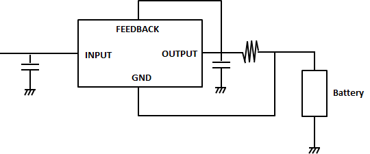

    Is the folllowing LP2951 schematic correct for this application?
    Yaita

  • Hello Yaita-san,
    Yes, the way that you connected it in your drawing is correct. With Feedback connected to the output.
    As for the Vin question.
    If Vin is disconnected altogether then you should be fine as there is no path for current to flow, except to maybe charge the capacitor on the input. If, however, you actually have the input grounded, then this might cause some current backflow. It is not recommended to connect it in this manner. A recommendation would be to put a diode from the source to the input before the input capacitor to prevent any large backflow.

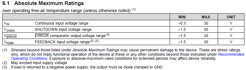

    I concern if the following Absolute Maximum Ratings are referenced with respect to GND pin.
    Is it possible to apply voltage to GND pin more than INPUT pin(Vin)?
    Yaita
  • Yaits-san,
    I apologize, i believe I misunderstood your question from the beginning.
    As you mentioned, if the input is grounded and the GND pin is a higher potential (higher than 0.3V) it is possible and likely that there would be damage to the device.
    I would not recommend using the device in this kind of scenario. I would try to make sure that the input disconnects and that it is not connected to ground. A forward diode from the input to help prevent current backflow would be recommended.
    In short, yes, the device should not have a higher potential on the GND than the input.
    Michael

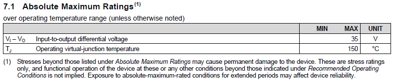

    Is the same equally true of LM317L? (LM317L should not have a higher potential on the OUTPUT than INPUT.)
    Yaita

  • Yaita-san,
    Yes, by having the adjust pin higher than the input, the out pin would also try to be above the input. This may cause backflow of current into the output of the regulator which could damage the device.
