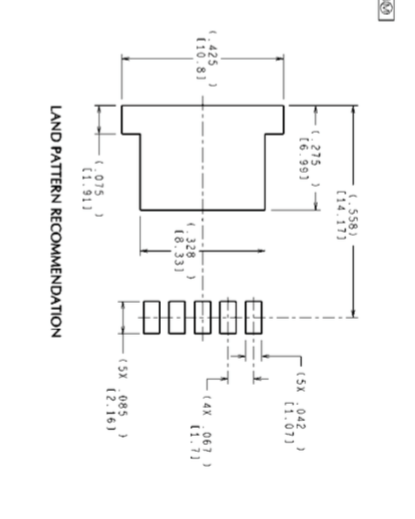

The land pattern of the LDO TPS75801KTTR (TO-263 package) seems not fit the actual layout of the exposed thermal tab.
The exposed shape on the back where the solder cream needs to be is not a square.
Is the land pattern right?
How does the LDO need to be layout on the land pattern?
The package information is at page 24 and the land pattern is on page 25 of the datasheet.
For example, I'm expecting a land pattern like for LP38500:
