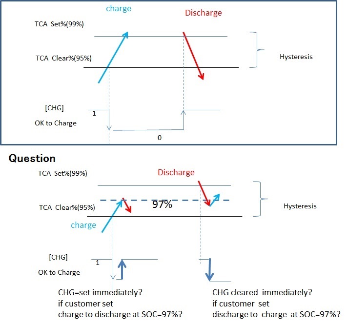

Hello
My Customter is evaluating  BQ27520-G4 using EVM. ( gg file attached ).
Attached image is their read-out from BQ27520-G4 when charging versus time.
The issue is   even though charging finished, i.e.  SOC=100%,  CHG flag goes from low to high  after 4.5hrs in attached. suddenly..
We know   CHG flag is set depend on SOC and Temperature , according to   TRM ( sluua35)  page 12 ,
but , customer says the BAT temperature is within the range , and  SOC is above the TCA clear%.
Would you please kindly adivise about the  condtion which CHG flag changes except SOC% and Temperature if there were ?
Cusomter can not understand the cause of thie issue now.

  • Your TCA Set % in the gg file is 99% therefore CHG will be set to 1 once SOC drops below 99%.
    Hello
    Thank you for your adivse about  customer's gg file and waveform  immediately!!
    So,.... customer says it may be SOC% is below 99%  but,  it is  not below  95%...
    Please let me have additional questions  about   bq27520-G4 TRM sluua35.pdf [CHG] bit and TCA Set%, TCA Clear% .
    Sorry to bother you again
    ~~TRM~~
    (1)We see TRM Page 12, ;
    CHG = Indicates OK to charge. This bit is set if StateOfCharge( ) is below "TCA Set %" and
    Temperature( ) is within the ranges set by Chg Inhibit Temp Low/High and Suspend Low/High Temp.
    (2)On the other hand, in TRM Page 48,;
    TCA Set % is the Terminate Charge Alarm Set Percentage threshold. TCA Set % sets a StateOfCharge( )
    percentage threshold at which the Flags( ) [CHG] bit is "cleared".
    Q1
    So, our ( customer and my ) understanding is following, but is this correct?
    [CHG] bit is 0 if SOC% >  99% =TCA Set%
    [CHG] bit is 1 if SOC% <  95% =TCA Clear%
    Q2
    If Q1 was correct, I thik page 12 or page 48 has some typo , and I think following is correct for page 12, is n't it?
    CHG = Indicates OK to charge. This bit is set if StateOfCharge( ) is below "TCA Clear %" and
    Q3
    Our ( customer and my ) understanding for TCA Set% and TCA Clear % and [CHG] bit is like hysteresis..,
    how do you think about?
    If charging from SOC% low to high and SOC% is above 95%; [CHG] is 1 ( no change )
    If charging from SOC% 95% to 100% and SOC% is above 99%; [CHG] is 0
    If discharging from 100% to 95% and SOC% is within 95% and 99%; [CHG] = 0 ( no change. acts as  hysteresis )
    If discharging from 95% to less , ; [CHG ] =1
    With My Best Regards
  • If the SOC falls below TCA set (default 99%) during discharging, CHG will be set which indicates that it is now ok to charge.
    If the SOC rises above TCA clear (default 95%) during charging, CHG will be cleared which indicates that it is not ok to charge (again).
    The default is a hysteresis of 4%.
    If the For example: SOC = 20% -> CHG = 1. Now you charge the battery - CHG will clear once the SOC >95%.
    Other example: SOC = 100%. CHG = 0 when SOC crossed 95% during previous charging. Now you discharge the battery. CHG will be set once the SOC < 99%.
  • Dear Hartl san
    Thank you for your answer !!
    Please let me confirm  in case SOC% is 97% ( within hysteresis).
    Is following correct? or something wrong? Tihs is question fom my customer.
    * [CHG] is set  to 1  immediately when cutomer set charging  to discharging  at  SOC&=97%
    * [CHG] is cleared to 0 immediately when customer set discharging to charging at SOC = 97%
    I had attached the drawing.
    Sorry to  bother you again but please advise.
    Best Regards
  • Hi Kanji,
    That's not normal. chg should set if SOC is lower than TCA set and clear when SOC is lower than TCA clear . ps review you gg setting if you are getting otherwise and log data too as well for debug purposes
    thanks
    Onux
  • Dear Onix san
    Thank you for your advise soon. I will talk with my customer.
