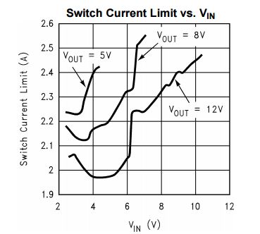

I have chose LM2700 WEBench Designer for 2.3V VIN minimum and maximum, 9.3V VOut and 230mA . i have used high efficiency mode.
What are all the parameters will impact when i use the same circuit component with 4.6V VIN.
I have attached the circuit for reference.

  • Hi Sivaraman,
    There are a number of parameters that change if you increase the input voltage from 2.3V to 4.6V. I will try and list all of them in this post:

    2. Switching current limit changes as you change the input/output voltage range as shown in plot below:

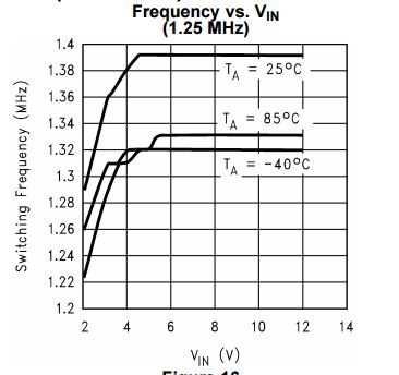

    5. Finally the switching frequency accuracy is positively effected at higher input voltage. Please see the following fig:
    For more detailed plots, please refer to datasheet typical application graph 8 to 16.
