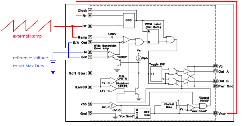

PFM design for UC2825
Guru 29720 points
Other Parts Discussed in Thread: UC2825, UCC25600
Hi Team,
My customer considers to design not PWM mode(fixed frequency) but PFM mode with UC2825.
He considers to input external Ramp signal to Ramp pin and not using internal OSC as the following schematic.
Do you think it is reasonable design for UC2825?
