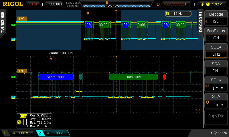

Some scope images to illustrate the problem:
Here everything works, reading the voltage (this is after the hard-reset by shorting REG27)

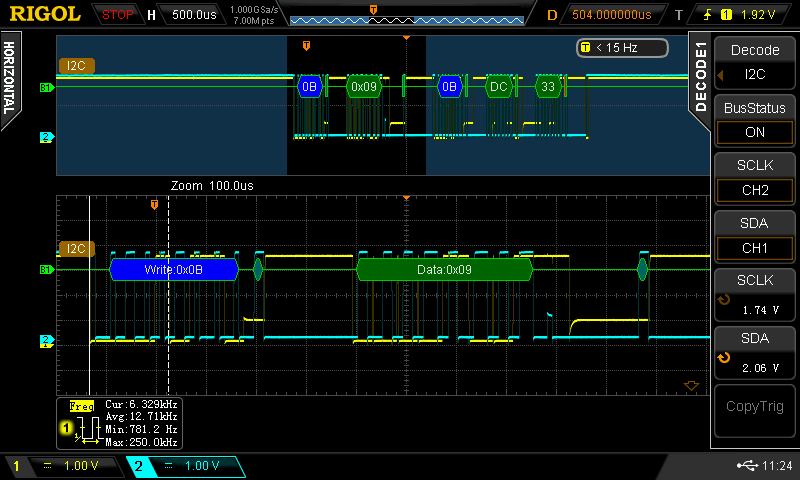

Here the BQ3060 ACKs its address, but NACKs the command following it.

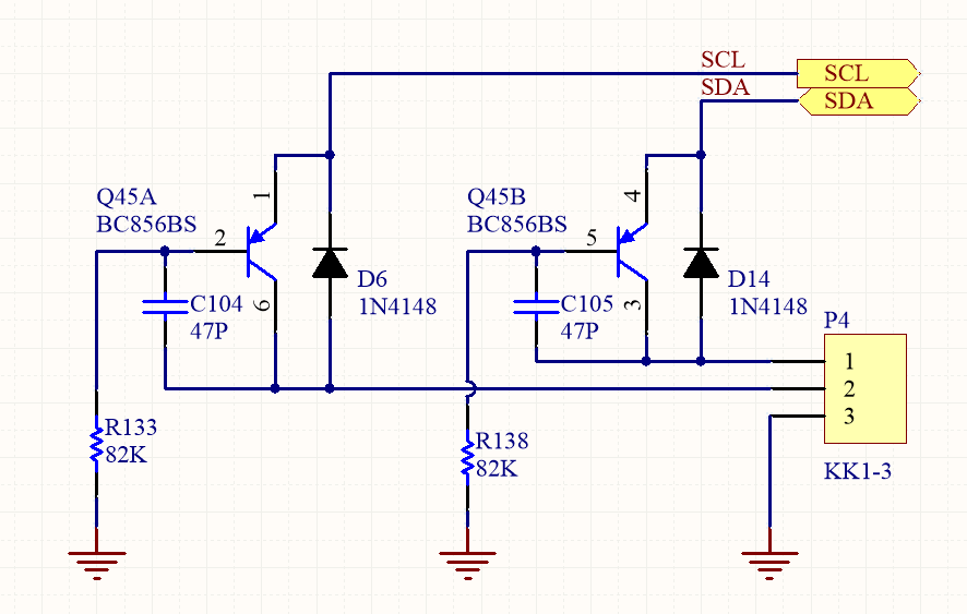

The strange "hops" in the voltage are caused by the levelshifter circuit I had to implement (the signal is sampled at SCL/SDA, on our board, not at the BQ3060 side). The designers of the BMS disconnect the GND of the battery, using N-Ch FETS as opposed to the P-Ch ones as suggested by the application note. (this potentially leads to the voltage on the SDA/SCL to turn negative when the BMS disconnects)
Diagram of the levelshifter:
SDA/SCL are connected to the main processor on our board, connector P4 connects to the BMS. The ground of the BMS is not wired separately because that would bypass the N-Channel fets. Unfortunately we don't posses the schematic of the BMS, the supplier is reluctant to hand it over. (we might eventually design it ourselves but we need to get this resolved).

    I reviewed the original posting and am not sure why it was not answered earlier. If the gauge is returning to normal operation after resetting REG27, then the firmware may not be running properly. Dimitri mentioned that the SDA and SCL pins may be pulled below VSS at times and this could cause a latch-up condition. He also mentioned that n-channel FETs were used instead of p-channel FETs. If he is referring to the CHG and DSG FETs, then the device does not supprot n-channel FETs. Please provide a schematic and I can review it. So, to analyze to problem, I would look for conditions where the pins could be pulled more than 0.3V below VSS. You can also check the thermistor pins to see whether they are pulsing to check whether the firmware is running.
