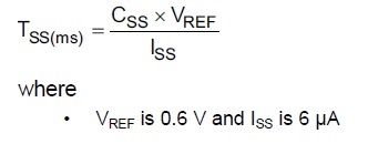

Dear Sir
I use below equation to calculate if Css=10nF ,the Tss(ms) will be 0.001mS
Could you help to double confirm??
1 msec or 0.001 sec is what I calculate. To be safe I always use std units.
