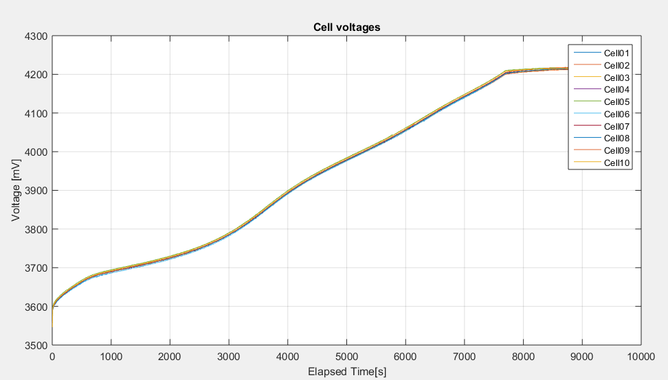

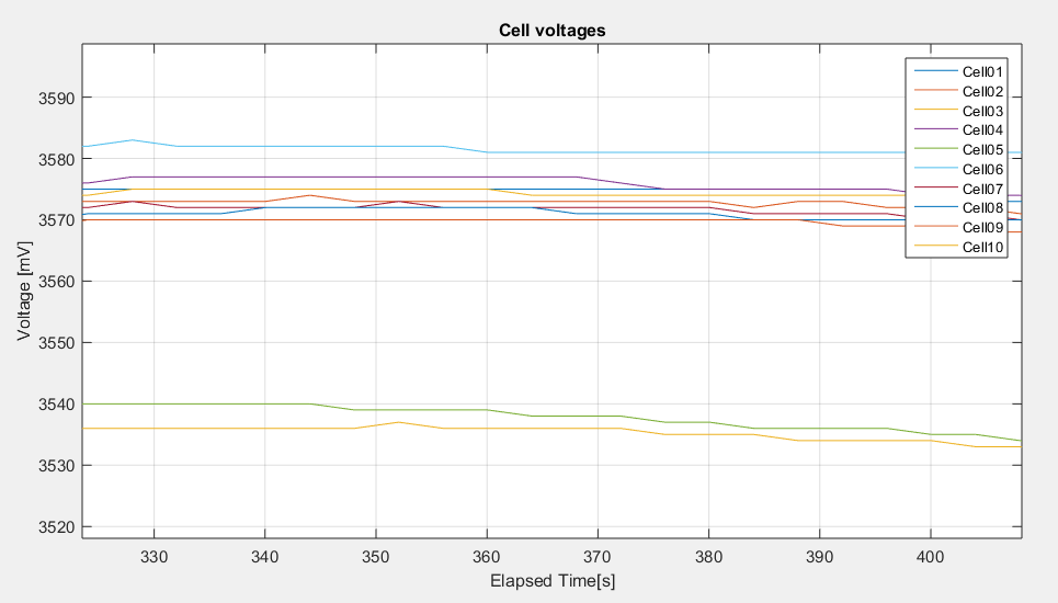

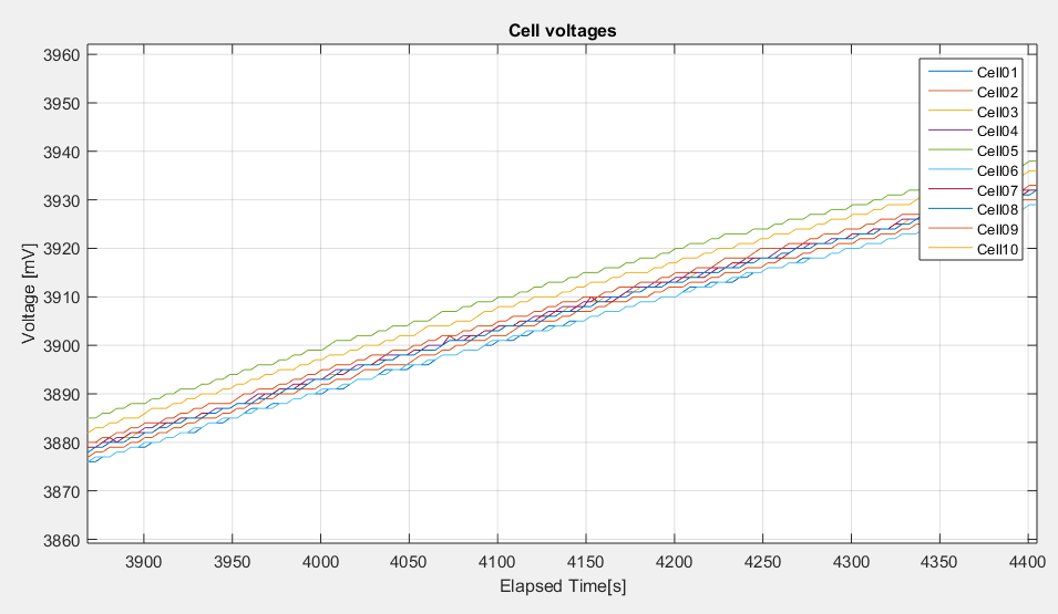

  •     Hi Thomas
    We are generating the discharging profiles and start to notice something. As you can see in the attached images, Cell05 and Cell10 voltages shows a different behavior respect other Cells. Their voltage drop more during discharge mode and rise more during charge mode.
    We are using the Evaluation module bq76930EVM for charge and discharge the battery pack. The cells are new and completely balanced at the begging of the test.
    Have you seen this before? What do you think is happening?
    Thanks in advance
  • It is usually an indicator that the series resistance is higher and the cell is damaged, if a cell trends higher during charging and lower during charging. Have you measured the cell voltages with a volt meter to verify whether they are really different?
  • Hi Thomas
    I just measured the cell voltages with a voltmeter:
    Cell01: 3592mV
    Cell02: 3592mV
    Cell03: 3592mV
    Cell04: 3592mV
    Cell05: 3592mV
    Cell06: 3592mV
    Cell07: 3591mV
    Cell08: 3590mV
    Cell09: 3591mV
    Cell10: 3592mV
    What do you recommend to do in the next step?

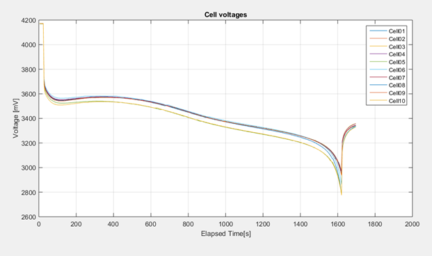

  • Hi Thomas
    I am performing the discharge profiles for CEDV coefficients determination. My discharge rates rates are 14A and 7A at 0°C, 25°C, and 45°C; however, I expect to discharge no more than 7A at 45°C in the real application.
    Is it possible to set the hightemp_highrate and hightemp_lowrate files with the same discharge profile at 7A? or Do I must perform the test for 14A at 45°C?

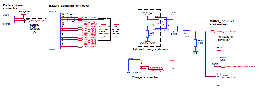

    As you can see, we are implementing a top side MOSFET configuration; this circuit is consuming 100uA to keep enabled the DSG and CHG MOSFET. We decide to implement an integrated charger module (always connected to the VBAT-GND net). This charger is always drawing something around 500uA from the battery pack.
