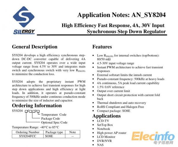

Currently see Silergy SY8204 spec as below,
I think two device can replace it, but if you best solution please advise me, thanks.
TPS54531 >> none-sync, efficiency not good
LM25117 >> too expensive and more external component, efficiency is good
application backlight power
Please promote TPS54531 to compete with Silergy, we have new 28V,2A, 3A parts, TPS56302, tps54202, but don't have 4A part.
