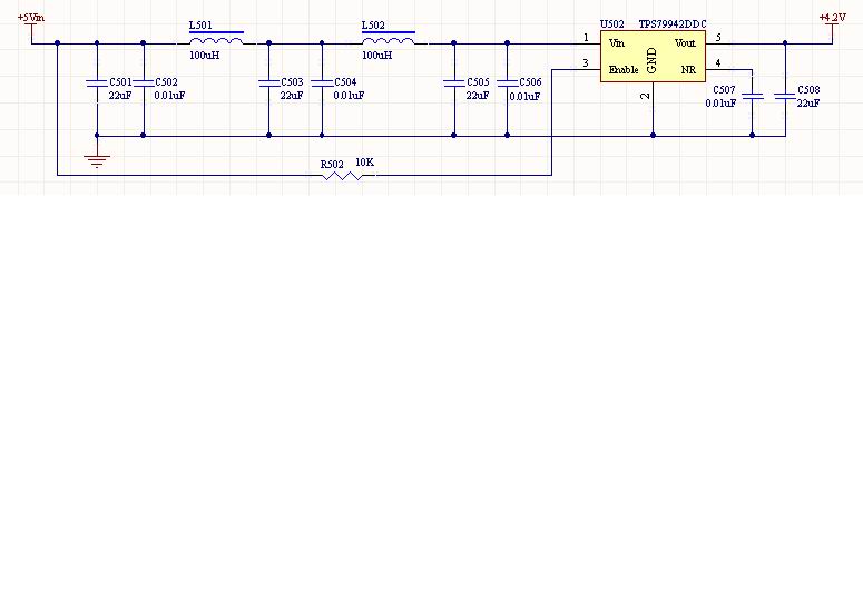

TPS79942 Vout=Vin=5.192V
TPS79942,
The Circuitry is show up. When the Vin=5.192V,
The Vout=5.192V,(It should be 4.2V)
Where is wrong?Thanks

  • Bill Thank  you very much.This is my schematic
  • Hello Zhuo,
    Your schematic looks fine.  I see that you are taking many precautions against startup transients and overshoot.  Have you found the problem yet?
    Have you tried powering-up the circuit from a 5V lab supply (instead of the ac-dc of the ac-dc adaptor)?
    Our first concern is that the ac-dc adaptor output overshoots above 7V absolute maximum rating on the Vin pin. And our second concern is that the combination of inductors and ceramic capacitors on the input is forming a Hi-Q resonance that causes an overshoot on startup that destroys the part.
    I have no speculation as to why the Cnr capacitor would cause the output to change.  Apparently the circuit is not very happy.
    Does the part immediately go to 5.192V output on startup? What happens when you disconnect the load?  Normally when we see a sinusoidal output we suspect that the circuit is unstable.  Is the oscillation present immediately at startup? When you try turning on the circuit with the lab supply perhaps you can try bypassing the input filter to see the effect.
    As an added precaution, perhaps new sample parts should be ordered for the case that your present parts have been damaged in some way.
    Bill

  • Hi Bill
      Thank you!My problem has been solved.The problem lies on the ac-dc adaptor.The output of my AC-DC adaptor may rush up to 6.5V when starting,so that my TPS79942 was damaged.I changed a lab power supply and a new TPS79942 chip,then the problem was solved.
      My suggestion is: the power supply(that can damage the COMS gate) as well as the Cout(that can make the output instable)  is important for the Linear Regulators.
