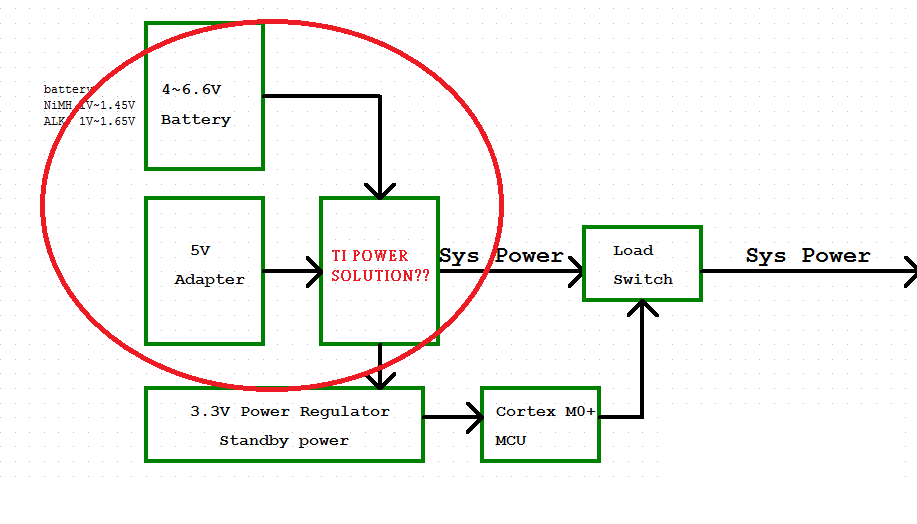

Survey TI have two input source, ORing controller integrated DC/DC Converter
Hi Sir,
Survey TI have two input source, ORing controller integrated DC/DC Converter?
when 5V adapter in, priority first and cut off battery source.
  • Hi Kuo,
    I am unaware of an integrated dual-ORing + DC/DC solution.
    What current level is the design? If the voltages were lower, then we have a selection of Power Multiplexer (PMUX) devices here:
    www.ti.com/.../power-multiplexer-mux-products.page
    However for wider voltage ranges and currents, I only know of single channel solutions such as eFuse devices which may be of interest. For example check out figure 76 on page 37 of the TPS25942 datasheet:
    www.ti.com/.../slvsce9.pdf
    I will transfer this question to the eFuse team which is under the load switches forum for additional assistance as they support these types of products.
