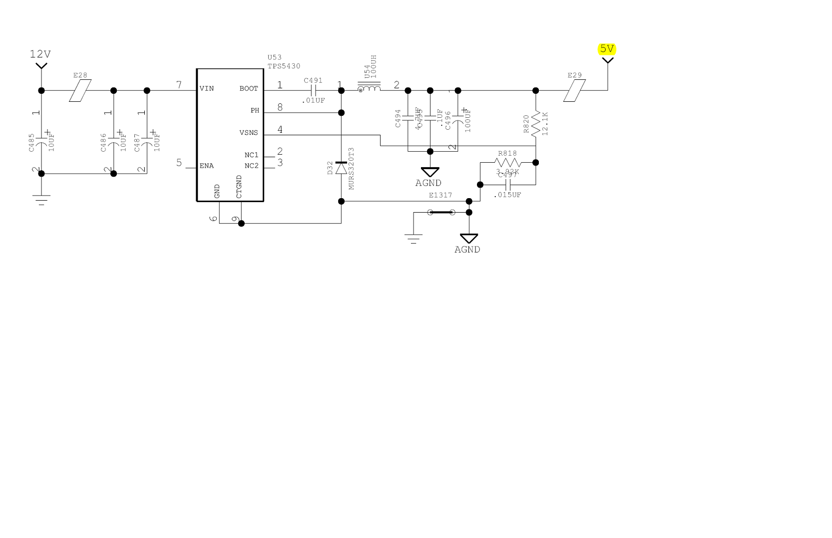

I have a problem with TPS5430 , it does't cold booted at cold temperature (-30 C) upon connection the 12V input voltage,
Scematics attached
