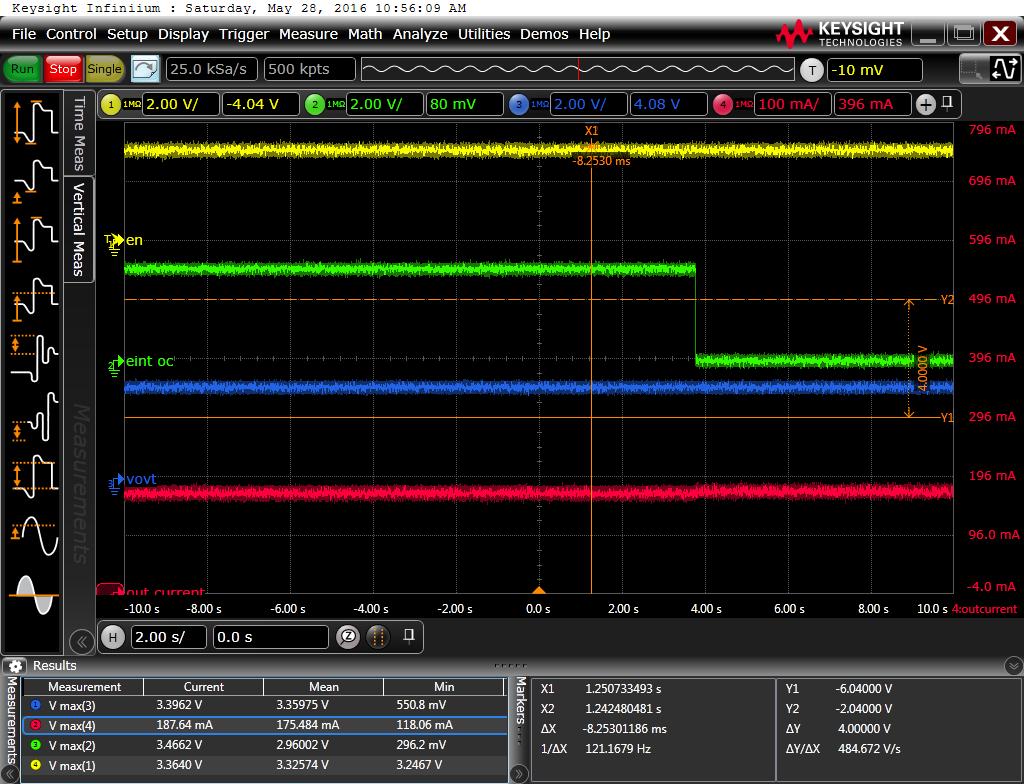

                I have some questions about the description in the datasheet:
               1)  Overcurrent Deglitch is available in the both of asserting and de-asserting the /FAULT , right ?
               2)  Deglitch is the delay time from detecting the overcurrent to asserting the /FAULT signal ,right ?  When the current is exceed the current limit and then go down below the current limit in the period of 7.5ms deglitch time , the /FAULT will still be asserted ?
               3) The Vout will go down near the zero when in the constant current mode of 2553, could you please see the test waveform below , the /fault is asserted, but the Vout is no changed , could please explain that?
               4)  The TPS2553-1 will be latch-off and turn off if in the current limit,  turn off means open the switcher and no output current and voltage ,right?

                   1)  Overcurrent Deglitch is available in the both of asserting and de-asserting the /FAULT , right ? Yes, for both OC and reverse voltage faults.
                   2)  Deglitch is the delay time from detecting the overcurrent to asserting the /FAULT signal ,right ? Yes. When the current is exceed the current limit and then go down below the current limit in the period of 7.5ms deglitch time , the /FAULT will still be asserted ? Yes
                   3) The Vout will go down near the zero when in the constant current mode of 2553, could you please see the test waveform below , the /fault is asserted, but the Vout is no changed , could please explain that? Refer to figure 4. Vout may not go all the way to zero for soft overloads. What is your current limit setpoint?
                   4)  The TPS2553-1 will be latch-off and turn off if in the current limit,  turn off means open the switcher and no output current and voltage ,right? Yes.

               For question 3) , the setting resistor is 150kOhm , so the Ilim(nor)= 175mA.  In sight of the plot , the /fault will be asserted so long as the current reach the current limit no matter the soft or the heavy overload , right ?
               One more question , it is a valid overcurrent event so long as its duration is reach 2uS (tios) ,right?
  • Yes, /FLT will assert under any current limit condition.
    Tios is a spec that quantifies how fast the switch can react to a hard overload condition and fully shut down the current. See figure 3 for an example of the behavior.
