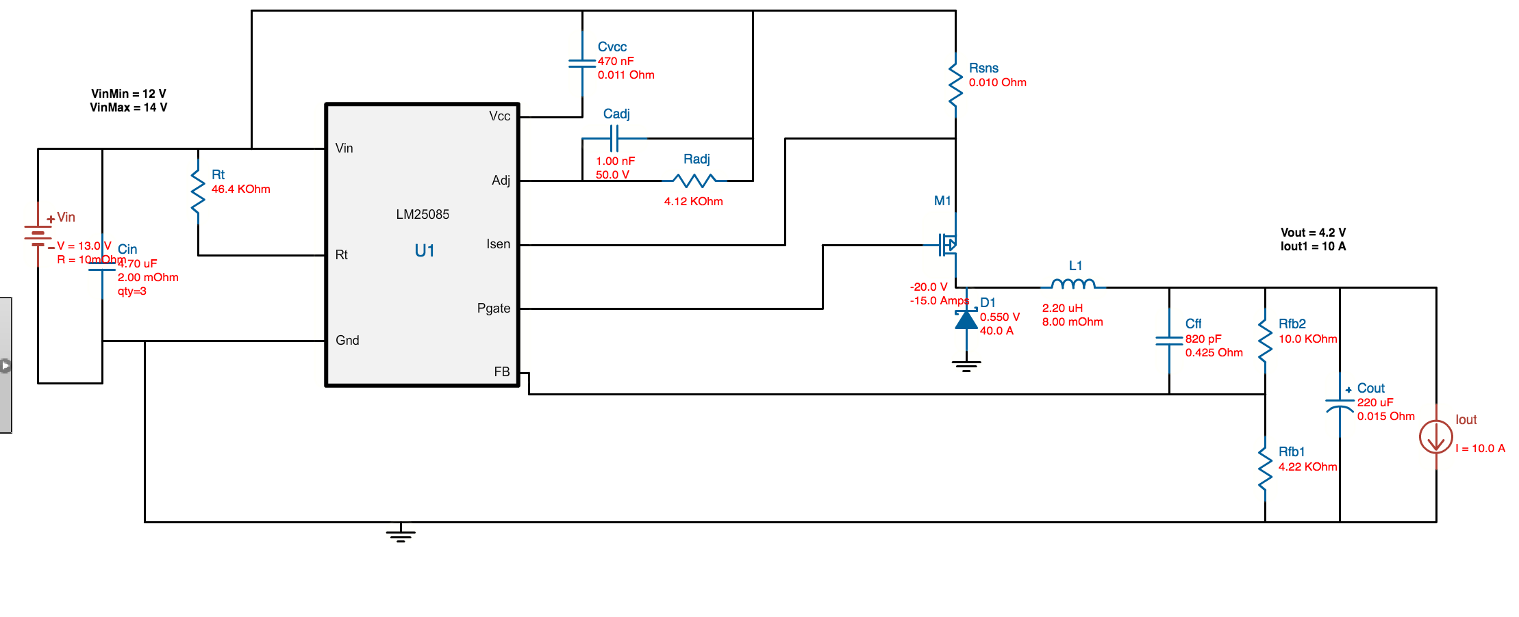

I designed a LM25085 circuit with TI Webench,
My Requirments:
Vin Max: 14V
Vin Min:12V
Vout: 4.2
Iout: 10A
I designed this circuit for Li-Ion Battery Charger, When I finished PCB,I've measured the output voltage, it's 4.22V...it's correct, but when I connect to Li-Ion Batteries
Voltage down to Battery's Voltage, there have no current through to Battery....
