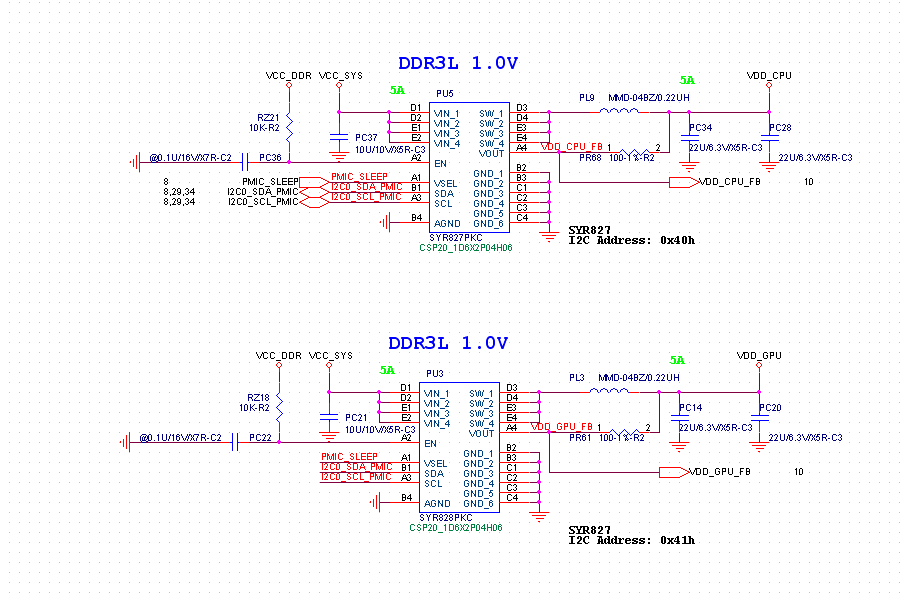

Hi Sir,
My customer survey have I2C DC/DC Converter to replace SILERGY SYR828 / SY827,
we promote TPS62366A/B to him, but package can not meet request, him consider process production problem.
if you have best solution, please let me know, thanks.

Yes, the TPS62366 is most similar. What is wrong with it? The Silergy IC seems to also be in a CSP package and with a smaller 0.4 mm pitch, so it is harder to assemble than TPS62366.
