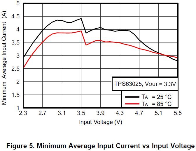

  • Hi Sabrina,
    Let me ask one more another question.
    The description of short circuit protection in datasheet page 9 states that the input current is limited to 4A, but I believe that it's limited to "Average input current limit". And so the limit will depend on input voltage and temperature like Fig.5 in datasheet. Is my understanding correct?
    I guess it because there is following description in TPS63060 datasheet.
    During a short-circuit situation on the output, the device maintains the current limit below 2 A typically (minimum average inductance current).
    Sonoki
  • Yes, the device limits the average input current to 4A during short-circuit. As you said the input current depends on the operating conditions but will not go above 4A if a short-circuit is detected.
  • Hi Sabrina,
    Thank you for your comment. I understand that the average input current may be over 4A at normal operation as Fig.5, but it will not go above 4A at short circuit condition. Is my understanding correct?
    Sonoki
  • Yes correct
