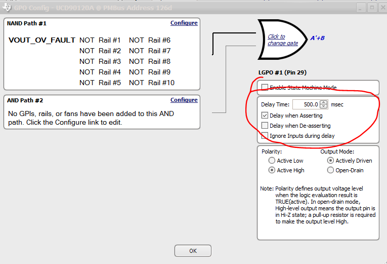

 ・Can UCD90120A variable "Fault to Alert" time on resister setting?
 ・About alert function of voltage monitoring, can alert GPIO collectively one channel?
  ※For example; monitoring 10 voltage rail condition,
         if someone has over warn, customer hope that from the same GPIO alert output.

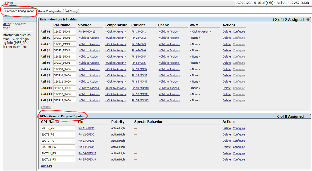

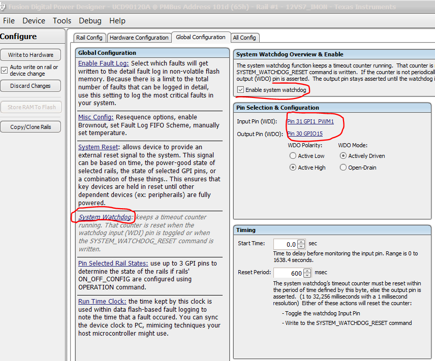

 ・We cant configuration WDI setting, is there condition of configuration Watch Dog time?

    [3] For the WDI setting. Go to --Global Configuration--system watchdog.
    Also make sure you have assigned at least one GPI pin.

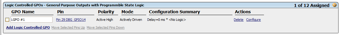

  • You can also use Logic GPOs to  response the faults you specified.  And the response time can be specified by yourself.
    Let's take your case as an example:
    If  you are monitoring  10 power rails' voltage, and what we want is any fault  of the 10 power rails will trigger the same GPO output.
    The logic would be  Y= V1+V2+V3+.........V10 =  Not{  V1' &&  V2' && V3' ...........&&V10' }
    Go to Hardware configure-->Logic controlled GPO
    Press configure
    I selected to response for Over voltage faults, you can specify your own.
    Also, we can specify the response time here:
